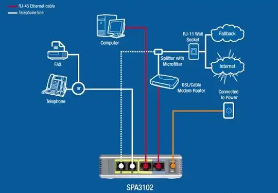

But you still need a PSTN Gateway- You can't (and please do not) connect PSTN directly to your Pi or any custom made device. A cheap and good one is Linksys PAP2T and lots on ebay. I would recommend SPA3102 and that is what I used at home.
Then you configure the SPA3102 to forward calls to uElastix and you can write custom scripts in Asterisk to execute PHP files, Bash Scripts or anything you want!
