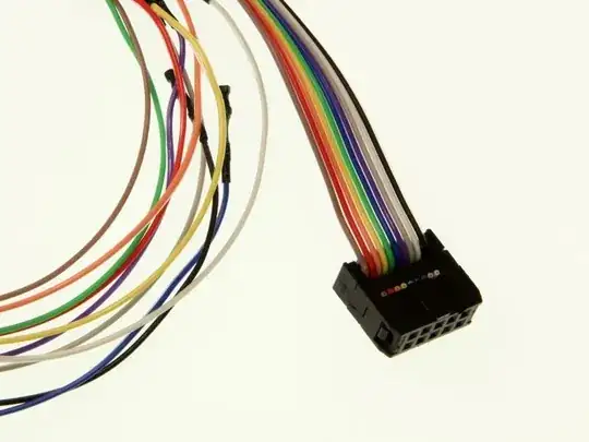

Another way to keep your GPIO ports clear physically is to use a GPIO extension cable or ribbon cable instead of directly soldering the board onto the Pi. Since the SPI pins (which PiTFT uses) are concentrated at the end of the GPIO, you can get away with a 5*2 pin or 6*2 pin connector.
