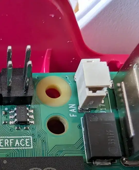

I can see where I'm supposed to plug the fan cable but it's covered up and I'm scared to tug on it in case I break it. Is there some knack to opening it?
close up of fan socket

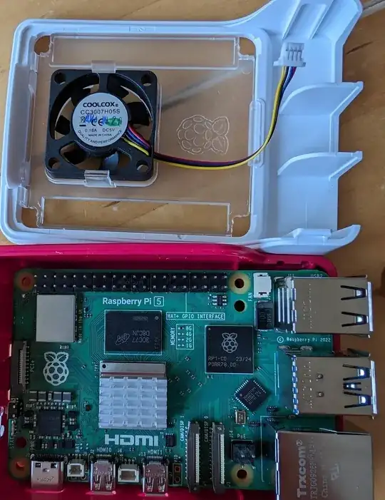

picture of rp5 and case

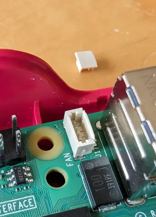

Ah, I figured it out, I was pulling the wrong bit, you just need to pull the square off the top.
pi5 with fan socket cap removed

It's not obvious that the receptacle has a cap, particularly with weak eyesight. I broke off the header trying to remove it.
