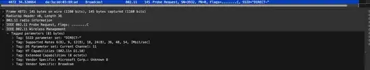

Upon getting sniffer logs for the test, I found out that the Probe Requests from Raspberrypi are missing P2P IE so the Android phone just ignores it and doesn't respond to it.
I have tried this with Raspberrypi 3B+ and 4B and with software version 2021-05-28 (Buster) and 2023-05-03 (Bullseye) versions and the same issue is seen across the board.
sniffer log: P2P Probe Request from Raspberrypi with no P2P IE Raspberrypi log snippet:

Upon looking at the raw hexdump data of the IEs in the log, it looks like supplicant is correctly including the P2P IE OUI (50 6F 9A) but for some reason the Raspberrypi kernel/driver is dropping it before broadcasting the Probe request.
