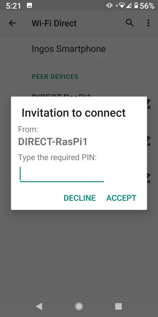

Connect with mandatory method, using pin code asked by the smartphone
The Wi-Fi Direct specification defines that the pin code connection has to be supported by all compliant devices as default. So we will first use this method to be on the save side. Please follow the steps exactly in this order to have the handshake correct. If in doubt, start again from the beginning (see section ♦ Troubleshooting).

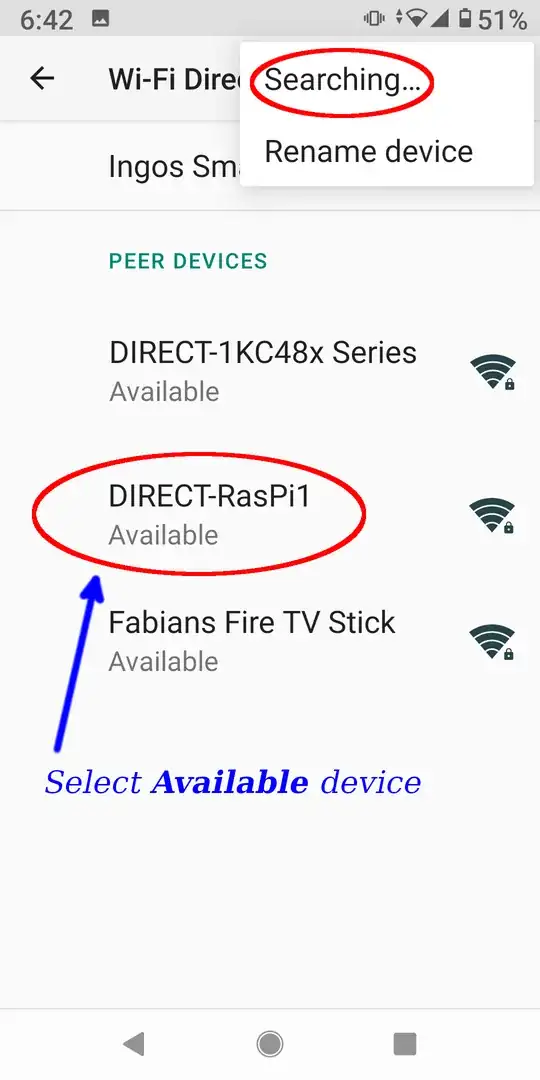

On the RasPi I start finding devices:
rpi ~$ wpa_cli -i p2p-dev-wlan0 p2p_find
Now I go to the WiFi Direct page on my smartphone
Settings -> Network & Internet -> Wi-Fi -> Wi-Fi preferences -> Advanced -> Wi-Fi Direct. Tick the three-point in the upper right corner and select Search for devices if not already Searching... and tick the DIRECT-RasPi1:

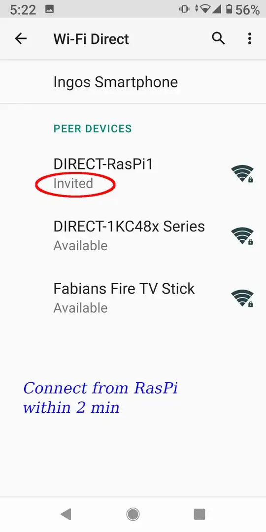

You have two minutes time to response. Now I can look with wpa_cli -i p2p-dev-wlan0 p2p_peers what mac addresses of found devices are available. Then I have to show the details for every mac address with wpa_cli -i p2p-dev-wlan0 p2p_peer <MAC-ADDR> what name it has to find my smartphone. I do it with this one liner, for example:
rpi ~$ for i in $( wpa_cli -i p2p-dev-wlan0 p2p_peers ); do echo -n "$i "; wpa_cli -i p2p-dev-wlan0 p2p_peer $i | grep device_name=; done
86:cf:bf:8e:f1:06 device_name=Ingos Smartphone
32:cd:a7:f2:ee:5c device_name=DIRECT-1KC48x Series
and find 86:cf:bf:8e:f1:06 for Ingos Smartphone. Now I only work with this mac address (p2p_dev_addr) and connect to it. Note that we use pin auth (pin authentication). This will return a pin on the console:
rpi ~$ wpa_cli -i p2p-dev-wlan0 p2p_connect 86:cf:bf:8e:f1:06 pin auth
87160055rpi ~$
On the smartphone just type in the given pin (here it's 87160055). The status will then change to Connected:
Go now to section Test and finish the network connection

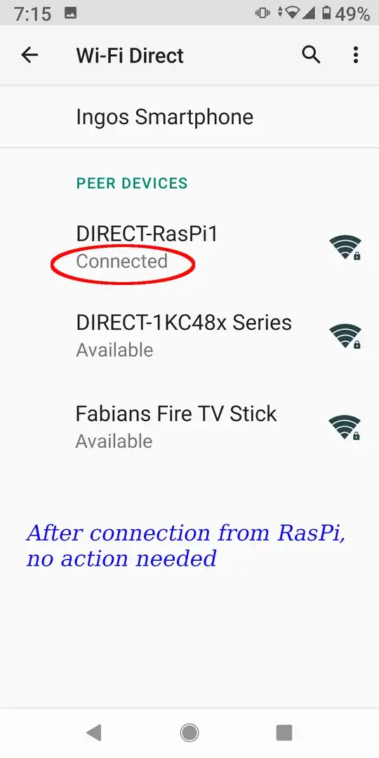

rpi ~$ wpa_cli -i p2p-dev-wlan0 p2p_connect 86:cf:bf:8e:f1:06 pbc
OK
On the smartphone the status will then change to Connected:

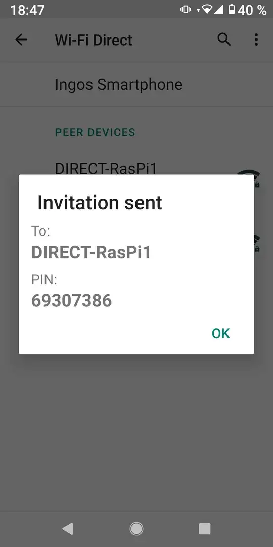

rpi ~$ wpa_cli -i p2p-dev-wlan0 set config_methods virtual_display
Settings -> Network & Internet -> Wi-Fi -> Wi-Fi preferences -> Advanced -> Wi-Fi Direct. Tick the three-point in the upper right corner and select Search for devices if not already Searching... and tick the DIRECT-RasPi1. You are presented a pin:
and find 86:cf:bf:8e:f1:06 for Ingos Smartphone. Now I only work with this mac address (p2p_dev_addr) and connect to it. Note that we use the pin presented by the smartphone (here 69307386):
rpi ~$ wpa_cli -i p2p-dev-wlan0 p2p_connect 86:cf:bf:8e:f1:06 69307386
OK
On the smartphone click OK to the Invitation sent and the status will change to Connected:

p2p_find(the WiFi name will become visible to the clients and marked as “available”). CTRL-EVENT-SCAN-STARTED events are received. - the client selects the connection; in consequence of the previous server setup (virtual_push_button), it will use PCB mode, so the state will go to “invited” without password pop-up)

p2p_connect <addr> pbc; notice that it is not strictly necessary to wait for the client connection to invoke p2p_connect: it might be issued just afterp2p_find, but the client can deny the connection depending on its state, returning FAIL; notice also that the p2p_connect will be interrupted by any other sent command, like p2p_find: in order to avoid interrupting the connection with another command, AP-STA-CONNECTED should be waited within a congruent timeout period. - the received events are P2P-FIND-STOPPED, P2P-GO-NEG-SUCCESS, CTRL-EVENT-SCAN-RESULTS, P2P-GROUP-FORMATION-SUCCESS, P2P-GROUP-STARTED (followed by the group name, which is useful to be registered in order to allow deleting it on client disconnection), AP-STA-CONNECTED. The client sets the “connected” state after receiving an IP address.
- if the client disconnects, the AP-STA-DISCONNECTED event is received. Alternatively, the group can be removed in order to produce the disconnection of the client.

P2P-PROV-DISC-SHOW-PIN,P2P-GO-NEG-REQUEST,P2P-DEVICE-FOUND` - the client pops up the password message; enter an 8-digit password
- send
p2p_connect <addr> <8-digit password> display - received events P2P-FIND-STOPPED, P2P-GO-NEG-SUCCESS, CTRL-EVENT-SCAN-RESULTS, P2P-GROUP-FORMATION-SUCCESS, P2P-GROUP-STARTED (followed by the group name, which is useful to be registered in order to allow deleting it on client disconnection), AP-STA-CONNECTED. The client sets the “connected” state after receiving an IP address.

If p2p_connect fails, first check the existence of EBUSY errors 16 in journalctl, meaning that a group or an AP had already been allocated; then verify that the client accepted the request.
To start a Wi-Fi Direct connection with Android and connect a Raspberry Pi AP, tap Settings > Wi-Fi > Advanced settings > Wi-Fi Direct and wait for the Raspberry Pi peer device to appear.
