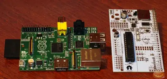

Wyolum mas the aLaMode (I call it the Almond Pi) to fit on top of the Pi in a stackable manner. It has a real-time clock, uses a aTiny 328, feeds of the GPIO Real UART / power and is flashable in various ways. It is great because the Pi can do whatever you want it do , web server/database while the Arduino runs in real-time interrupt.
