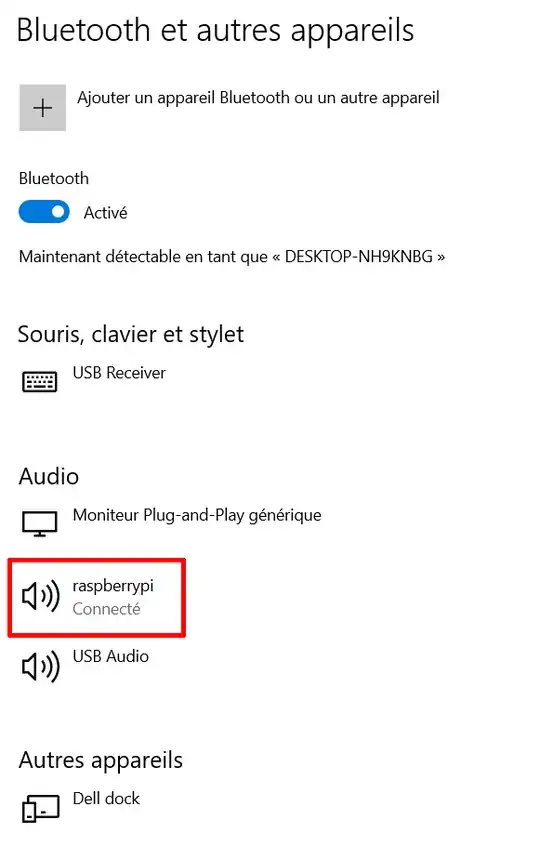

The problem I have is the following: when setting my Raspberry Pi Bluetooth as discoverable, then pairing from a Windows laptop, the Raspberry is incorrectly identified as an audio device, as can be seen on the following screenshot. (This is using Raspberry Pi OS version 11 - Bullseye)
RPi detected as audio device
I would want this Raspberry Pi to be identified as other device.

Among other things, I have tried changing the Bluetooth device class. This will change the icon displayed on windows, but not the category under which the device is listed. It seems that windows is using another method to determine whether a device is audio or not, which remains quite mysterious to me.
