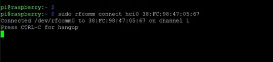

I did the scanning, pairing and trusting using the bluetoothctl utility, then I used the rfcomm utility to create a COM port (/dev/rfcomm0) on Debian side: sudo rfcomm connect hci0 38:FC:98:47:05:67 - W10 automatically connected and it's looking like this:

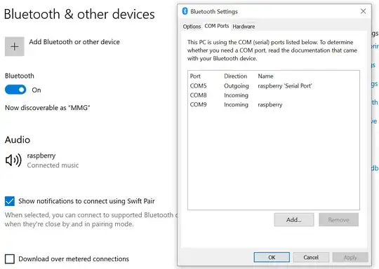

On the W10 machine I now now have this following setup: enter image description here

Now on W10 side I'm using RealTerm tool and I'm trying to connect to one of the new two COM ports that were created after pairing and connecting to Raspberry: (COM5 - Outgoing, and COM9 - Incoming) - not sure which one should be used so I'll just try both of them.

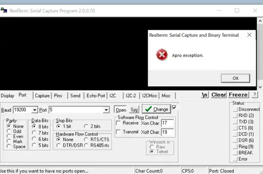

  • When trying to connect to COM5 RealTerm throws me the following error, so can't do any testing using this Outgoing COM port - I've also tested using TeraTerm - same issue, won't open the port: enter image description here

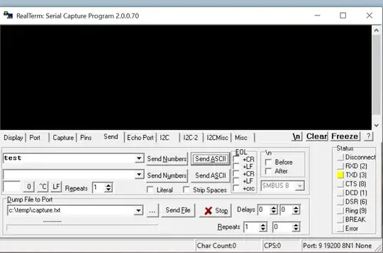

  • When trying to connect to COM9 RealTerm successfully connects but doesn't send any data over BT (or the Raspberry doesn't receive - not sure), and this weird thing: TXD "pin" remains always ON until I disconnect: enter image description here
On the Raspberry side all this time the screen terminal session is still active and blank - if I'm pressing some keys nothing shows on RealTerm (COM9) side.

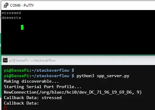

Once you have that running you can move on to the Windows client. Initially I used the following Python code (In python 3.9 or newer) to establish the connection:
import socket
server_address = "B8:27:EB:22:57:E0" server_port = 1
with socket.socket(socket.AF_BLUETOOTH, socket.SOCK_STREAM, socket.BTPROTO_RFCOMM) as c:
c.connect((server_address, server_port))
c.send(b'desserts')
print(c.recv(1024).decode())
Again, have a bluetoothctl open on the RPi to respond to pairing requests.
Once I had done this once I had a device with the correct kind of port available
And could connect with putty:
