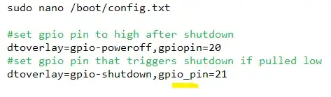

you could use overlays for this.
In the example above gpio pin 20 is high after shutdown (notice the underscore difference if you also want to shutdown via gpio).

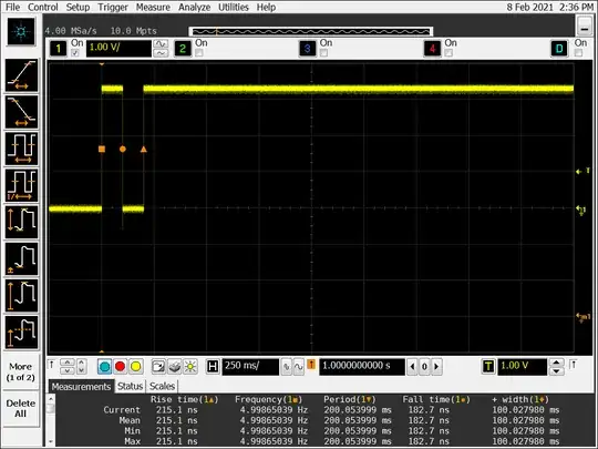

Note the oscilloscope trace below: This shows what the gpio-poweroff signal looks like when triggered by the device tree overlay - which may be added with a single line in /boot/config.txt:
dtoverlay=gpio-poweroff
You can find some version of the documentation on device tree overlays and parameters in the local file on your RPi: /boot/overlays/README. The current overlay documentation is available here, and should be consulted to ensure you're working with the latest information.
As you can guess from the trace below, the gpio-poweroff signal provides a useful signal to control the hardware that removes the 5V power input to the RPi; e.g. a latching relay.
gpio-poweroff signal generated by overlay
