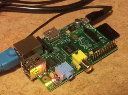

I have a Model B with 2 USB ports. From what I can tell this is the very first version. See picture below from when it was functioning long ago.
It was last used in 2014 with a then-current version of Raspbian, but I lost the memory card.
