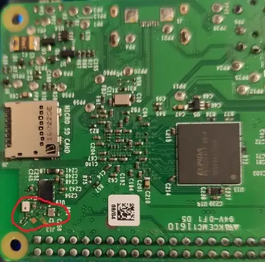

I haven't used the pi for a few month now , it was stored in good condition. so yesterday i flashed the SD card with rasbian bullseye and booted up the pi. every thing was normal except the wifi , i couldnt connect to the wifi it said no wireless interface found. so i unpluged it and left it off till today and when i try to boot it up there is no response now , no leds nor any display output , i lifted up the pi and my had got kinda burned so i unpluged it removed the sd card , the card wasnt hot it was just one electrical component on the backside of the pi thats getting hot(no smoke or smell)
when i plug it in ( ive marked its approximate location in the image. so now it wont boot and it wont light up the led ( both green and red ) and when i plug it in it that part of the pi( in the image) get really hot.I was using a 5v 2A adapter , tried powering it from computer usb 3 port too , still the same result. can someone please help with this issue?

The Pi is broken. There is no economical repair. The most inexpensive and quickest solution is to buy a new Pi.
