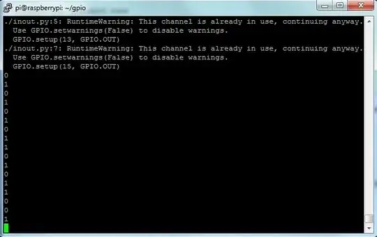

Hi I just bought raspberry pi since I found it very interesting.I want to know how from a circuitry (push button to print 1,2,3 or 4) can be displayed to the web server or somewhere in the computer to store. For the video of circuitry and codes is getting form here: http://www.youtube.com/watch?v=q_NvDTZIaS4 but I edited a little bit to the code to print 1 or 2 respectively for each button if I have 2 for example. Then I use putty to connect to the raspberry pi wirelessly then running the program in root so putty black screen would show 1 or 0 if I press the respective push button. Now I was wondering how to send these output datas to the web server or some where to store in the pc. enter image description here So in conclusion when I press the button that suppose to display a 4, it will display in the webserver for e.g. Then press another button to display 3 so it will display 4 3 in the webserver and so on and so forth. I did see a tut from How do I send data from the Raspberry Pi to the PC about webpy but its manual and send like"hello woorld" which was typed and not from the output of python scripts. I'm not really good with codes it'll be a great help if the tut is specific,easy example/video.TY
