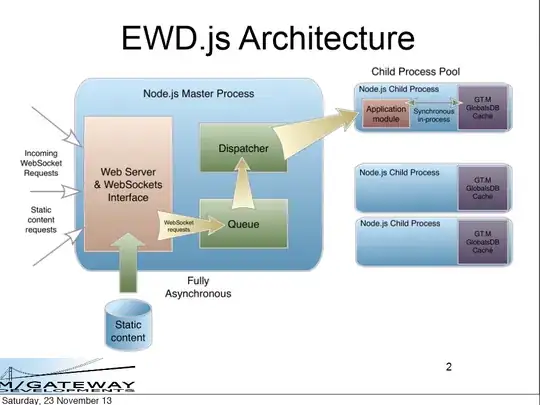

EWD.js could be a possible solution:
ewdGateway2 includes an entirely WebSocket-based framework known as EWD.js.
https://github.com/robtweed/ewdGateway2
Full Documentation
http://gradvs1.mgateway.com/download/EWDjsMechanics.pdf
