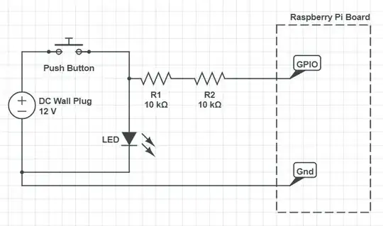

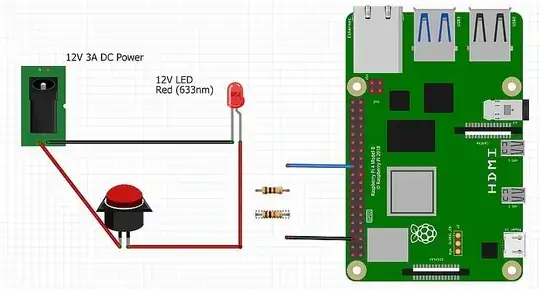

Hoping someone can help me with connecting my 12V push button LED circuit to a PI GPIO. I want to be able to sense when the button is pressed and the LED lights up using python.
From what I've read I know I will need at least one resistor to bring down the 12V to 3.3V and I need to connect to a common ground.
I will power the Pi with a separate USB input, so I can avoid buying any transistors or stepdown devices. I think I only need one or two resistors - maybe 1K and 1000K ohm???
Not sure where to insert into current circuit and what size resistor(s) to use
Connect 12V LED circuit to Pi GPIO

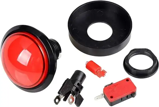

EDIT: Here is the actual LED/button combination Amazon LED/button
And yes - it does work fine with the 12V wall wart. Lights up when circuit closes. I think I can get the voltage down to 3V with a couple resistors in series so GPIO will be able to trap button presses
Here's a Circuit Lab diagram of what I'm trying - not sure about resistor values yet or if I should add another one down to Ground like you show?
current attempt

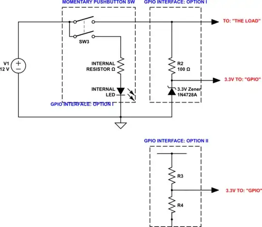

The illuminated pushbutton switch may be a DPST switch - as shown in Schematic A below. But even if it's SPST, it doesn't change the fact that the LED must have a current-limiting resistor. The form of the switch (SPST v DPST) doesn't change the interface requirements either. A part number or schematic of the switch would enable us to sort that out, but again, I don't feel it makes a huge difference unless it's a very specialized switch.
The schematic below (Schematic A) shows two options for the interface - Option I & Option II:
1. Option I: Zener Diode
A zener diode limits the voltage at the GPIO pin to 3.3V. It will maintain this 3.3V limit over a wide range of power supply voltages. This reduces the risk of damaging your RPi - and the circuitry behind the GPIO pins is very fragile.
2. Option II: Voltage Divider
A voltage divider will also work - although over a smaller range of input voltages than Option I. You have indicated this is your preferred solution due to parts availability - and that's fine, but you should be clear on the tradeoffs you're making.
Schematic A:
schematic
Voltage Divider Calculations for Option II:
The RPi's GPIO pins operate from a 3.3V supply; damage is almost guaranteed (see warning) if input voltages exceed that level. Consequently, the resistor values needed to set the voltage to be input to the RPi must be determined with some accuracy. This is a critical step; an error in this calculation may destroy your RPi. Fortunately for our RPi hardware, Ohm's Law, and the Wikipedia page on voltage dividers, provide guidance for calculating these resistor values:
Vout = Vin * R3 / (R3 + R4)
Vin = 12 V
Vout = 3.3 V Choose a value for R3, and calculate R4.
IOW, there are numerous combinations of R3, and R4 that will give the needed 3.3V - or close enough to it. For example:
Choose R3 = 10K & solve for R4:
R4 = R3 * 1 / ((Vin / Vout) -1)
R4 = 10,000 * 1 / ((12 / 3.3) - 1)
R4 = 3,793
And so you see that the process is to try to find a combination of resistors in your stock that will give the required value.
Finally on the subject of resistor selection for a voltage divider interface, there is one other important topic to address:
Voltage Thresholds for Logic HI (1) and Logic LO (0)
RPi GPIO are all digital IO, meaning there are only two valid states: High (1) and Low (0). But voltage, resistance and current are clearly creatures from the analog domain. This means that, as part of our voltage divider design, we must consider the voltage thresholds imposed upon us by this binary system.
These voltage thresholds are currently defined in the "Official" documentation. They are summarized as follows:
Binary Logic Level Worst-Case Voltage
Low / LO / 0 Vin ≤ 0.6 Volts
High / HI / 1 Vin ≥ 1.6 Volts
"Worst case" here means that for any (defined) value of VDD IO, the thresholds in the table above are valid. For the case at hand, the designer may use a value for R4 as low as ~1.8K. Since playing at the margins is usually risky business, the following values seem reasonable:
  • R3 = 10K
  • 2.7K ≤ R4 ≤ 3.3K .

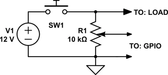

3. Option III: Potentiometer
A functional equivalent alternative to the voltage divider is to use a potentiometer with the wiper connected to the GPIO pin - see Schematic B below:
Schematic B:
schematic
simulate this circuit

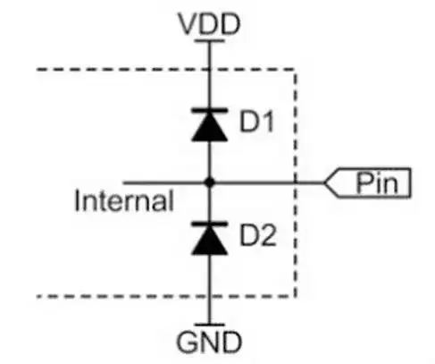

The clamping diodes shown in Schematic C below offer valuable risk reduction if a resistive divider, or a potentiometer, is used. You've indicated a preference for resistors only, but for the sake of completeness I'll include this option. A pair of clamping diodes connected across the GPIO input will provide additional protection. Note that the GPIO circuitry on the RPi already includes a pair of clamping diodes, but as they are elements of the integrated circuit (parasitic FETs most likely), they have a very limited current-carrying capacity.

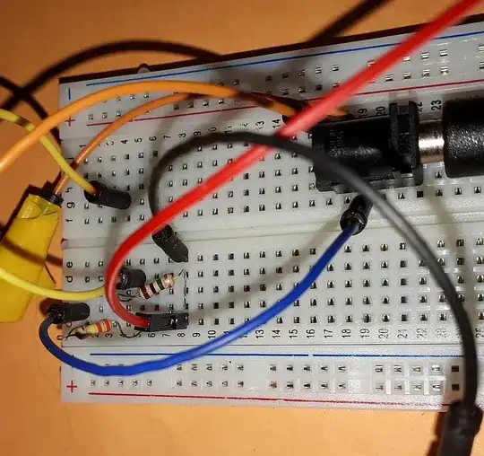

I managed to wade my way to a solution using examples and a resistance calculator - and with the suggestion from @Milliways on going to the GPIO in between two resistors and grounding the second resistor.

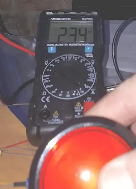

Initial power to LED is 12.31V and using the suggested 3:1 or 4:1 ratio from the voltage drop formula, I used R1=1MΩ and R2=330kΩ
Output to GPIO when LED is on now measure 2.34 V which should be safe for the Pi GPIO and a large enough number that my program can sense the change when LED is switched on by button.

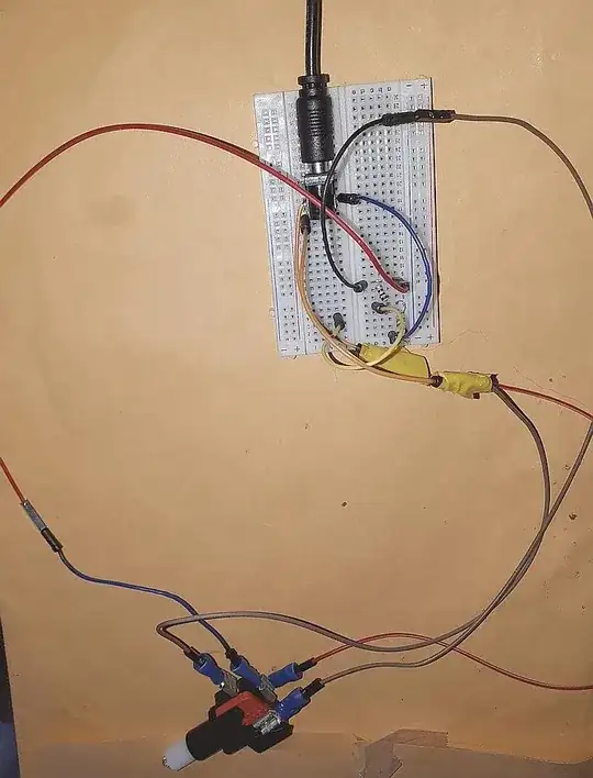

My ugly - working test breadboard layout and resistor connections are shown below. The LED has been pulled from the big button and I just used the small side switch on side of LED to test - same one that button pushes spring down on to.
I will try to post the actual working circuit diagram so as to not scare anyone
breadboard layout and connection to LED button
[resistors2
And here's a pic with me holding down the light with the voltage reading in background. Tricky to do with timed photo and holding leads and button down...
voltage reading

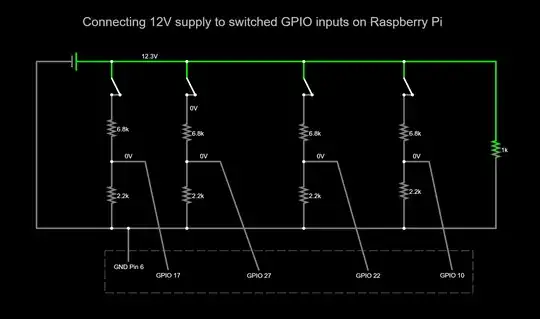

EDIT - FINAL CIRCUIT BOARD LAYOUT
Updated picture of circuit - this looks closer to what mine should look like connected to Raspberry Pi (voltage divider calculator) and a Raspberry Pi Forum example
Example Finished Circuit

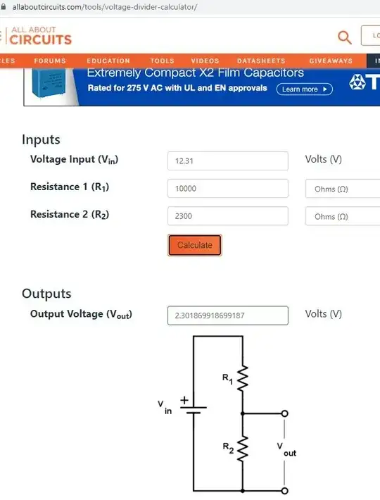

EDIT 1 - I had to change the resistors as 2.3V was not producing reliable push button detection. Changed from R1=10k, R2=2.3k to R1=6.8K R2=2.2K to give Vout = 3.0V
EDIT 2: CHANGED RESISTORS Final working circuit on falstad
Final Circuit getting 3.0V to GPIO
