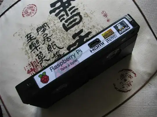

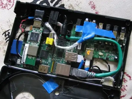

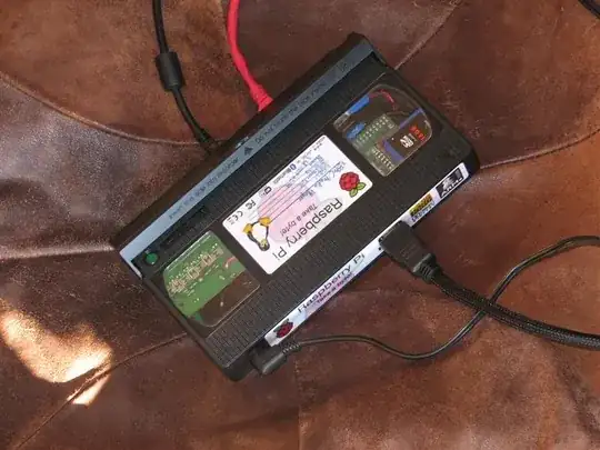

VHS-Pi (Credit to Maarten) as a case - built as a portable media server (when visiting friends)
Includes:
-RaspPi (duh) fully un-modified with the following directly connected
--Ethernet 'break-out' cable
--Audio 'break-out' cable (not fully completed yet)
--5v Supplied over GPIO
-7-Port D-link Hub (4 ports exposed, 3 for internal use)
--Wifi dongle
--Bluetooth dongle
--USB thumbdrive for added storage (not pictured)
Plugged in enter image description here
Inside the VHS Tape Case
source and more photos http://www.raspberrypi.org/phpBB3/viewtopic.php?t=12925&p=136708

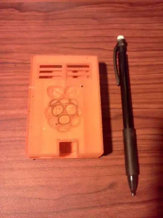

I have a 3D printed case. If you know anyone with access to a 3D printer, there are a variety of case designs freely available on thingiverse.
3D printed case
