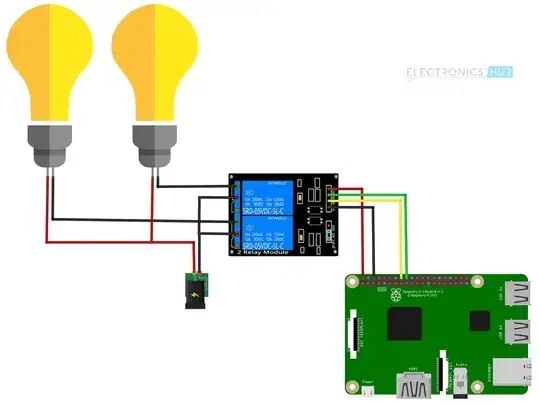

I want to know if is it possible to power the logic circuit of an external component used with raspberry pi not in the way shown below (using the 3.3v or 5v ang GRND GPIO),
but with an external 3.3v or 5v power supply like AA batteryexample logic circuit powered by raspberry pi GPIO
NOTE
I'm not talking about the powering of the WHOLE CIRCUIT or THE RASPBERRY ITSELF, but, in this case, the powering of the 5V 2 CHANNELS RELAY MODULE.

You CAN power external components; indeed for some this is recommended.
It is (generally) essential to share Gnd connections (opto-isolated devices are a possible exception).
There is actually no need in this case, as the Pi 5V can easily supply the current needed by 2 relay coils.
HOWEVER if you are using a relay module similar to that pictured they are UNSUITABLE for the Pi without additional components or modifications.
See Can you use a 5V Relay Module with the Pi?
