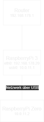

I tried the Solution from @Jaromanda X but unfortunately it didn't work for me. This instruction helped me very much: Cannot get internet from pizero connected to pi3 via USB (eth0 to usb0)
This is what I did:
on the pi 3/4
  1. The RaspberryPi needs a static IP-adress. You can either configure it in your Router (what I did) or you can set a static IP-adress in /etc/dhcpcd.conf like this:
# [/etc/dhcpcd.conf]
interface eth0 static_routers=192.168.178.1 # The IP-address of your router static domain_name_servers=192.168.178.1 static ip_address=192.168.178.XX/24 # replace XX through any IP-address you want
  1. You need a network interface for your USB-connection which you can also add in /etc/dhcpcd.conf:
Subnet for usb0 (where the piZero is plugged)
interface usb0 static ip_address=10.0.11.1/24
  1. enable IP-forwarding by uncommenting/adding the following in /etc/sysctl.conf:
# [/etc/sysctl.conf]
net.ipv4.ip_forward=1
  1. Configure the firewall of the RaspberryPi by executing the following commands in the terminal:
sudo iptables -t nat -A POSTROUTING -o eth0 -j MASQUERADE
sudo iptables -A FORWARD -i eth0 -o usb0 -m state --state RELATED,ESTABLISHED -j ACCEPT
sudo iptables -A FORWARD -i usb0 -o eth0 -j ACCEPT
Consider that these changes are only temporary. I put these commands into /etc/rc.local so that they are executed at every start of the pi. (I don't know if this is the best and recommended way to make the firewall settings persistent but it works)
on the pi zero
Setup the USB-inteface in /etc/dhcpcd.conf like this:
interface usb0
static ip_address=10.0.11.2
static routers=10.0.11.1
static domain_name_servers=8.8.8.8  # (Google DNS)
I also enabled dwc2 but I'm not sure if it's required.
Now you should be able to ping other devices in the internet or in your local network (e.g. 192.168.178.xx) from your RaspberryPi zero.
