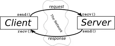

With this method, you are going to need a client and a server to communicate between the two Raspberry Pis. The exchange of information between client and server is summarized in this diagram:
Here is some C code for a server and client. All this server does is send the string "Hello, World!\n" out over a stream connection. All you need to do to test this server is run it in one window, and telnet to it from another with:
