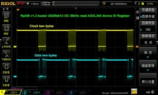

(9) Now coming back to your problem. What you want is just writing two bytes out, say first byte is 0x77, second byte is 0x88, then i2cBus just again do its job blindly, sending out 0x77, 0x88, I guess this is what you want. Let me know otherwise,
(10) I have a scope to display waveforms, I usually repeated indefinitely write two bytes, and pause 10mS every writing two bytes. I am happy to display the waveforms fro you.

Appendix B - I2C Sending two bytes
What is the max i2c speed of the raspberry pi 4?
Listing of program to write two bytes to device (actually at the same time read the ADXL345's ID register)
write two bytes
