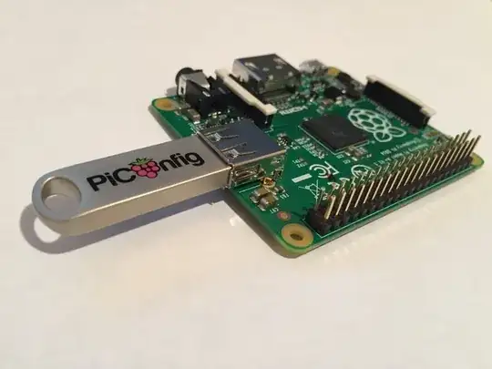

Yes, there is quite convenient method. Take a look at PiConfig - Raspberry Pi Network Configurator: https://www.kickstarter.com/projects/827010089/raspberry-pi-network-configurator-piconfig
https://www.geeky-gadgets.com/piconfig-raspberry-pi-network-configurator-23-03-2015/
This is a pendrive dedicated to set up a raspi. It was successfully funded at Kickstarter five years ago and it seems one can still buy it. PiConfig plugged into RPi
