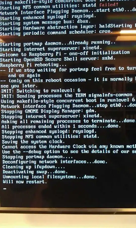

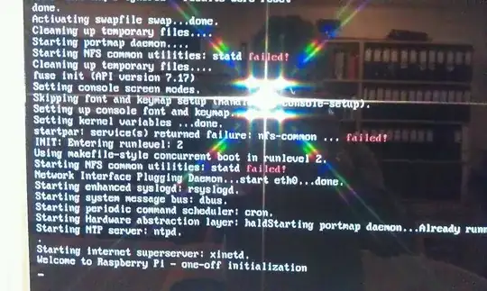

I have a Raspberry Pi running Debian. The boot.rc file in the boot partition is replaced with the boot_enable_ssh.rc so that I can access it with ssh. After that did not work, I connected it to a screen and watched the output. The boot process seems to be caught in a loop, it always comes to the "Raspberry Pi rebooting..." output, then some more and then it reboots.
I took two photos of the screen output, I hope it is possible to read and contains enough information: enter image description here enter image description here
After the last line in the second picture ("will now restart.") it reboots and comes to the same point. Can someone identify the problem? I noticed that the first mention of rebooting comes directly after the ssh server is loaded.
