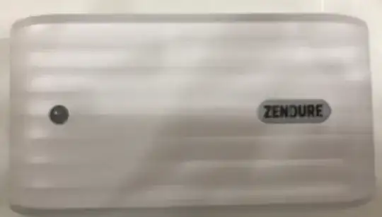

Zendure USB-C Power Bank:
Zendure Pic

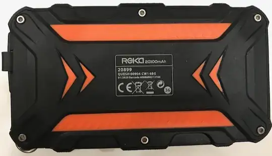

Reka USB-C Power Bank:
Reka Pic

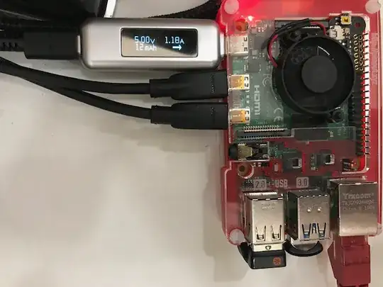

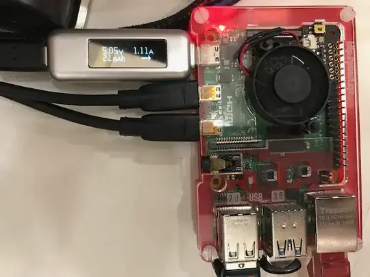

Test 1: Measure power connecting Pi to mains to establish baseline
5v was LOWEST voltage seen during monitoring period, while 1.18a was HIGHEST amperage range observed. MainsPower1
5.05v was HIGHEST voltage seen, while 1.15-16a tended to be LOWEST amperage observed. MainsPower2

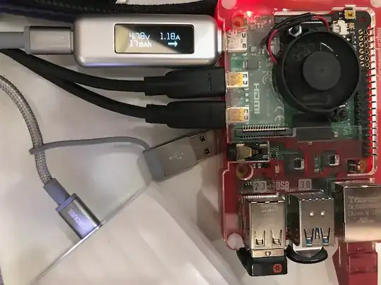

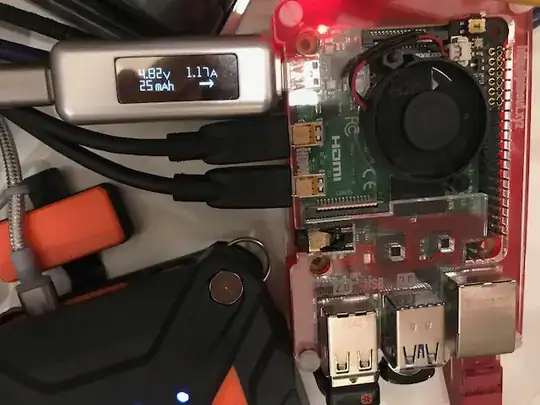

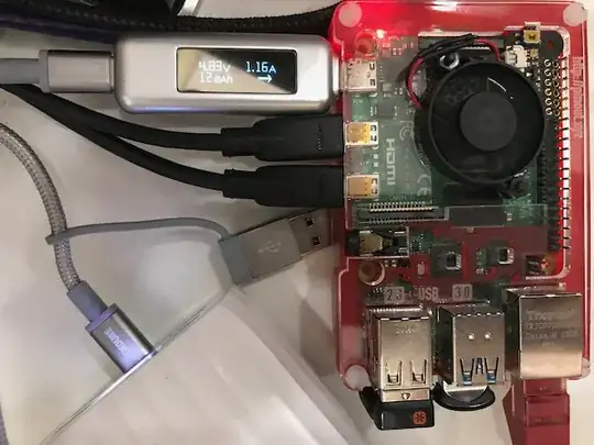

Power Bank #1: Zendure Tests w/ 21" Zendure Cable:
4.78v was LOWEST voltage seen, while 1.18a was HIGHEST amperage range observed ZendureBankZendureCable1
4.83v was HIGHEST voltage seen, while 1.16a was LOWEST amperage range observed ZendureBankZendureCable2

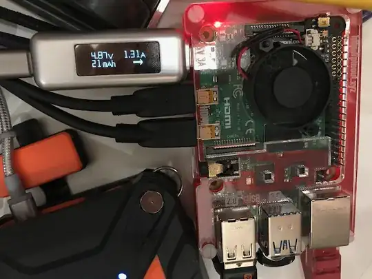

Power Bank #2: Reka Tests w/ 21" Zendure Cable:
4.82v was LOWEST voltage seen, while 1.17a was LOWEST amperage range observed RekaBankZendureCable1
4.87v representative of HIGHEST voltage seen, while 1.31a representative of HIGHEST amperage range observed RekaBankZendureCable2

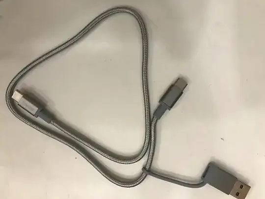

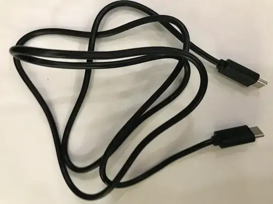

Test 3: Compare Power Banks connecting Pi w/ USB Cable #2
Cable used to connect each Power Bank to Pi 4: Reka 40" USBcable2Reka
Overall Results: A palpable reduction in voltage from using the Reka cable which at 40" was nearly TWICE as long as the Zendure's (21"). This was enough for the Pi to throw a Low Voltage warning when connected to the Zendure Power Bank using the longer cable. However, the Pi 4 did NOT show the dreaded "Lightning bolt" when connected to Reka Power Bank using it's own 40" USB-C cable.

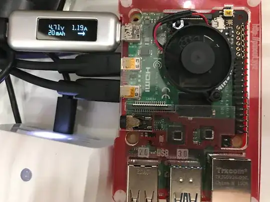

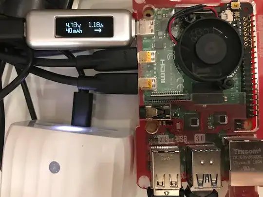

Power Bank #1: Zendure Tests W/ 40" Reka Cable:
4.71v was LOWEST voltage during monitoring period, while 1.19a was HIGHEST amperage range observed. ZendureBankRekaCable1
4.73v was HIGHEST voltage during monitoring period, while 1.18a was LOWEST amperage range observed. ZendureBankRekaCable2

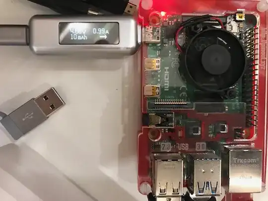

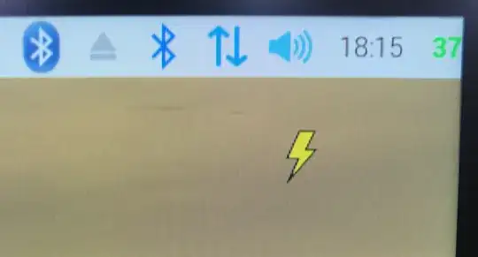

Result of Reduced Wattage:
Using Zendure Power Bank with longer 40" Reka cable resulted in an Under Voltage warning
LighteningBolt

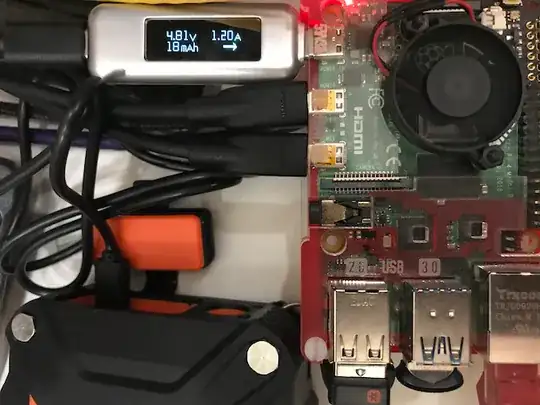

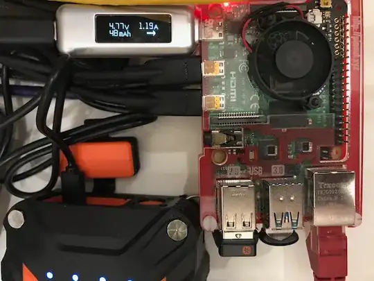

Power Bank #2: Reka Tests w/ 40" Reka Cable:
4.77v was LOWEST voltage during monitoring period, while 1.19a was LOWEST amperage range observed. RekaBankRekaCable1
4.81v was HIGHEST voltage during monitoring period, while 1.21a (1.20a shown)was HIGHEST amperage range observed. RekaBankRekaCable2

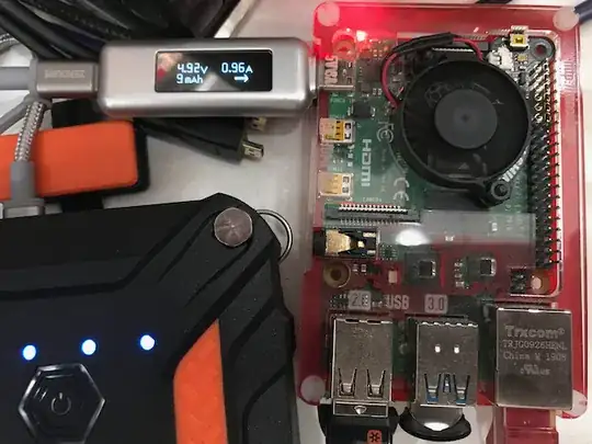

Reka Power Bank powering Pi4 w/ Zendure 21" Cable:
With the Reka using the Zendure cable we are now achieving 4.92v at 0.96 a whereas before with both HDMI cables connected the best we managed was 4.87v when amperage was 1.31a. Getting within touching distance of 5v now... RekaBankZendureCable1
