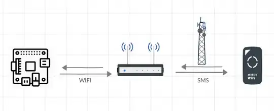

For a personal project, I'd like to use an MF920V modem. It's a mobile 4G modem made by ZTE. (Not to be confused with USB dongles).
The idea is to code an api with Python or Nodejs to remote control the Raspberry PI 3B+ through SMS. Using the same modem cell number. That could be used as a workaround for global network problems (IP, DNS...) and perform remote actions like rebooting the PI or rebooting the Modem itself... The pi would check sms messages received on the modem line and react based on instructions found in a preset sms models.
Remote network control using modem cell
Anybody tried working on that layer of communication with those modems? I'm sure it's possible because their Android app ZTE Link displays received sms and capable of other settings functions like rebooting, managing wifi settings... What protocol you think is being used to sync the App to the modem? SSH is possible but HTTP API is also possible like a manufacturer API right?

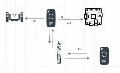

My first approach, was trying to use the SMSsync app on an old GalaxyS4. That network expects the phone to be both an SMS Gateway and an IR transmitter. It's a plus but with more equipments.
Remote network using another mobile cell
