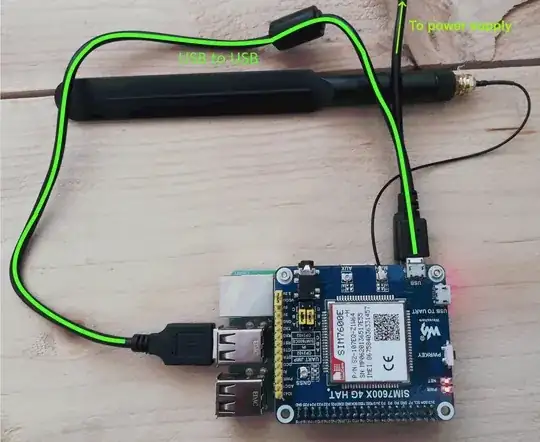

0. Setting up the hardware
Setting up the hardware is quite simple. You attach the hat onto the pi and connect the usb from the pi to the (micro) usb port on the hat (do not connect it to the usb-to-uart, that will not work).
I recommend to only connect the usb-to-usb connection whenever you are done with installing and updating the pi (so after 1.), just to be completely sure :)
Raspberry Pi setup with 4G Hat
