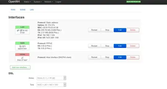

OpenWrt is the best choice for you. It makes Raspberry Pi to a wireless router device and you don't need to run a lot of commands. Easy to use with an interactive web user interface named LuCi like picture below:
I believe it going to help you better than in other ways.
The thing you should concern is that you should don't attend this page. As this page, OpenWrt is not on the supported list, however, you can install the bcm2709 by this link - Index of (root) / snapshots / targets / brcm2708 / bcm2709. Download rpi-2-ext4-factory.img.gz and write the image on a larger 256MB SD-Card.
The default IP is 192.168.1.1 and the DHCP server is disabled therefore add and static IP address to the host you want to configure RPi (such as 192.168.1.100), the default user is root and leave the password section blank.
Go to Network/Wireless then turn radio0 or WLAN on.
As I mentioned, it's easy to configure OpenWrt and you can configure it any way you want.
