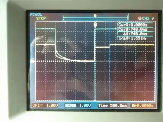

I have found the answer here thanks to russellstrong. I quote the relevant part below
I have jumped to conclusions about my pull up resistors / sensitivity of my circuit to the pull down resistors. The RPi is not setting the GPIO to output when first booted. It is turning on a pull down resistor for 740 milliseconds.
I have used two 18K resistors ( 3v3 -> GPIO -> GND ) to look at exactly what is going on with the pins. Here is the trace. Blue line is 3v3 power, yellow line is GPIO line.
