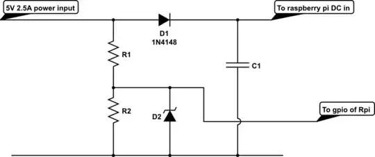

To achieve this thing you need two things.
  1. First, the power failure detection circuit.
  2. A power backup system that can give power back up to shut down the raspberry pi.
There are many ways to implement the power detection circuit. I am giving an example of this
schematic
In this circuit, the R1 and R2 you have to chose such that RPI gpio will get 3.3V, 3mA current. When the power supply presents the gpio will get a logic high(3.3V) signal and when failure will occur gpio will get logic low(0V).
For power back up you need a supercapacitor circuitry that can store 5V*2.5mA * 60sec energy minimum such that it can provide power to RPI when it performs shut down the operation. This circuitry should be placed in between the dc power supply and Rpi.
Prayuktibid
  • 157
