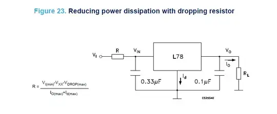

  2. reducing power dissipation with dropping resistor according to this circuit (note a required high power rating of the resistor, which will now share the burden with the regulator), (source):
