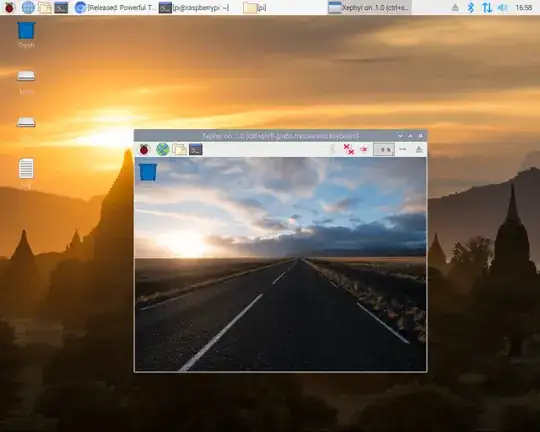

I have just released a script that will run a Raspbian Stretch virtual machine, inside the Raspbian Buster operating system. Not sure if it will work in your case, but it is definitely something to try if you don't want to wait for drivers to catch up.
vdesktop script
