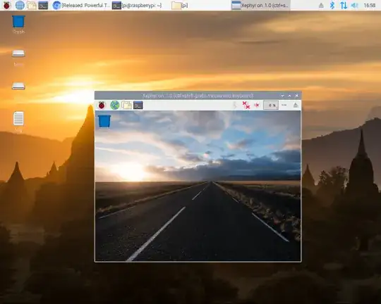

And I have released a bootable image to do exactly that. Just flash it to an SD card, then boot it, then click the menu item I added:
A terminal window will open with a full Stretch CLI. After you enter the username (pi) and password (raspberry), the graphical interface for Stretch will open in a VNC-style window.
And here is the final result:
