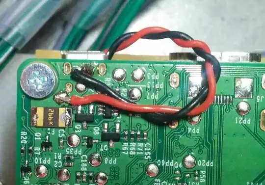

I want to attach a Raspberry Pi to hardware I'm developing. There is already +5v and GND available on the hardware. Is there any way to power up my Raspberry Pi from this (I just wanna avoid another micro USB cable inside my hardware if possible). Is there any safe way to so it through any GPIO pins?.

The safer is to connect between PP1 (5V) and PP5 (GND). You don't bypass the power fuse of the RPi. RPi power mod
