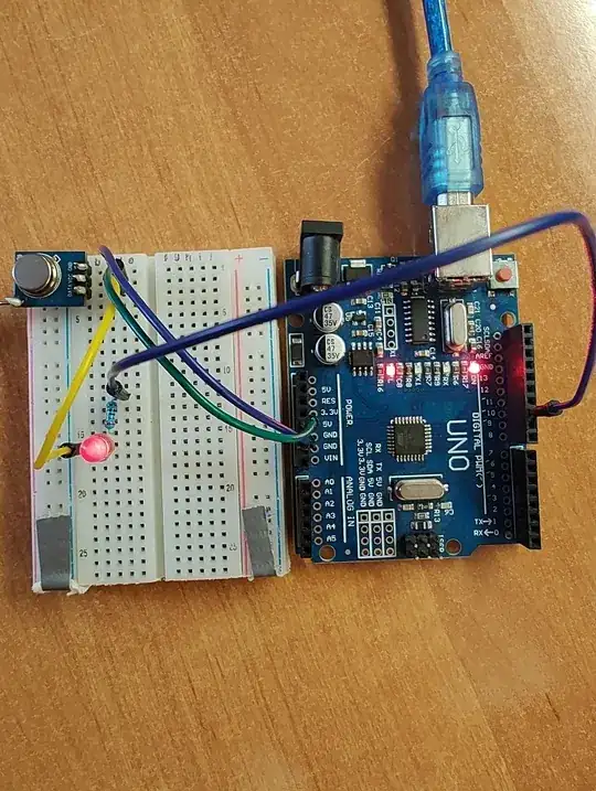

TRANSMITTER SETUP:
Transmitter setup
(note that there is an antenna soldered to the transmitter module, but it is out of frame) The LED is simply for me to see when a signal is send to the transmitter. (Blinks in intervals as intended)

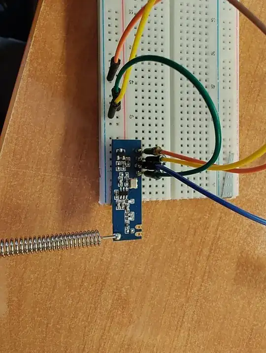

RECEIVER MODULE SETUP: Pins on receiver from left to right (form orange to green wire) are GND, CS, DATA, VCC. GND and CS are connected to the GND pin on Nano, VCC is connected to the 5V pin on Nano (this receiver works on 5V and does not require the usual ~3.3V). DATA is connected to the D2 pin on Nano.
Receiver module setup
The LED is simply connected to GND and pin D7 on Nano (out of frame) and does light up even if I touch the pin. LED stays off when D2 is grounded.
This setup does not work correctly and I have tried it for different Receivers/Transmitters (i have multiple of each). Once again thank you for all your suggestions. Does anyone have any idea what do I do wrong in here?
