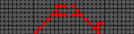

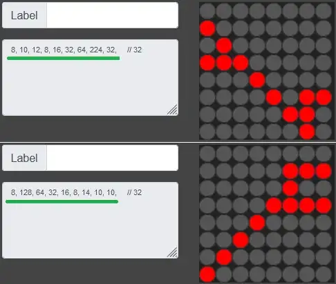

I'm using ESP8266 and Max7219 module (8*32) and MD_Parola library. To create my own font, at first I used of MDParolaFontEditor and created the following fonts.
I edited file MD_MAX72xx_font.cpp using Arduino IDE and saved them as 150 and 151. I want to have the output as the following.

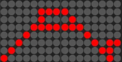

But, the output is as:
As you can see, there is a space between them! I think this space is automatically added between characters. My problem is that, how can I remove this space?

add this line in the void setup part
P.setCharSpacing(0);
Oscar
  • 36
The matrix with the extra space is 9 (not 8) columns wide (possibly because is was designed to be able to display a colon on a clock).
