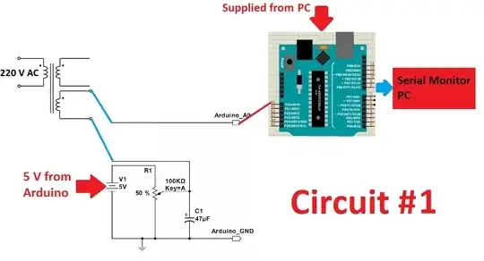

I want to display the true RMS of the main voltage using an Arduino and a MAX7219. At first, I used of circuit #1 (the following circuit) and the True RMS library. The circuit could successfully return the true RMS and print it on the Serial Monitor of thr Arduino every 0.5 s. The accuracy was acceptable. This circuit was supplied from a PC.
Circuit #1

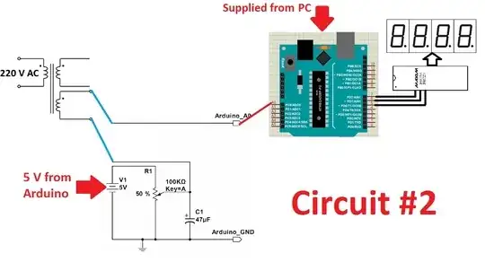

At the next step, I decided to use a MAX7219 (LedControl library) to display the true RMS voltage on a 7-segment display. For this, I used of circuit #2. I don't know what happened. The displayed voltage had variations. In circuit #1, the maximum error was 1 volt (checked by a true-RMS multimeter - for example, the voltage was 210 V and the printed voltage was 209 or 211 V). But in circuit #2, the error was up to 10 V with a fast variation. For example, the voltage was about 210 V (using multimeter) for a minute, but the displayed voltage by the Arduino was 203, then 209, then 217, then 205, then 200, then 215, ....

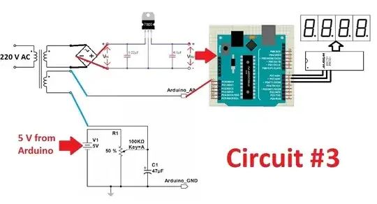

I also used of circuit #3, but I still had the same problem. It seems that the used of MAX7219 is causing the problem. What is the solution?
Circuit #2

Without seeing your code it's hard to guess completely, but this is my supposition:
  • The RMS measurement has to measure rapidly over a short period to capture the peak values of the AC waveform
  • You are updating the display while doing the measurement
  • The display updates slow down the sampling of the AC waveform giving you incorrect values.
You need to make sure that the sampling of the AC waveform happens fast enough by not doing anything else (much) during the sampling period and only displaying anything on the display when all the sampling for the current data point is done.
