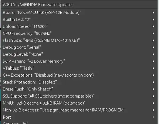

I am using a NodeMcu with Arduino IDE on Ubuntu. I have managed to upload the blink script and it work. Now, when i plug the nodemcu, the serial port /dev/ttyUSB0 is briefly available in the IDE. After 2 seconds, the port menu is grayed out again and I can't use it.
Same with ls /dev/tty* /dev/ttyUSB0 is briefly available.

How can I fix that? I have try all the usb ports. The NodeMCU settings: enter image description here
