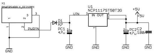

Lets study the schematic of Arduino UNO R3
The input from the power supply plug (PWRIN, the power jack) goes through a diode D1 (to prevent reverse polarity), and feeds a NCP1117 regulator that down converts it to the 5v supply that feeds the 5v parts.
Power input

Note that Vin is after the input diode so it's about 0.6V lower than the external connected power supply level. So when there is power supply connected to the power input that is higher than 6.6V+0.6V (where 0.6V is the diode D1 voltage drop), then the USB supply line is cutoff (because the mosfet turns off) and the power is provided from the power plug. Connecting or disconnecting the USB supply in this case will not make a difference, so you can have both power supplies connected simultaneously, only when the power input drops below the specified level (about 6.6V+0.6V=7.2V), the USB will start powering the board.
