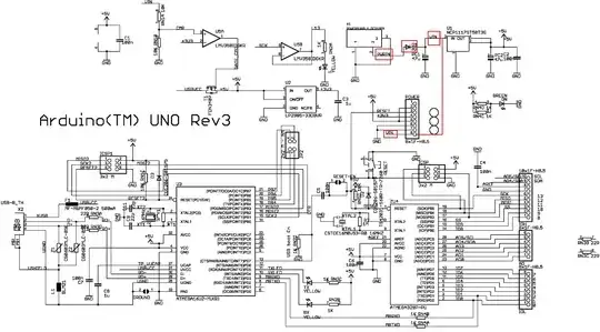

If this "Reference Schematic" is correct (as you'd hope it was) then Vin is connected to the "inside" of protection diode D1 - so D1 does not protect against reversed polarity. See lines and boxes in red.
Larger version of diagram here
D1 does protect against reversed polarity on "PWRIN".
How PWRIN relates to shield feeding I know not.
