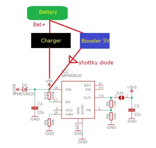

If I connect a battery charger/controller on VIN, my battery would be protected.
And I could connect a booster 5V and add a shottky diode so its connection to VIN would be closed if booster+ < VIN
Like this ?
charger + booster

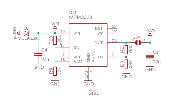

In this power block you can see there is only one Schottky diode with the voltage drop under 0.5V@2A. That means D2 is closed around the condition: VUSB < VIN.
On the other side if you add 3.6-4.2V battery on VIN there will be current flowing from VUSB to battery.
Basically you need another shottky diode Bat+ -> [A|K] -> VIN so when there is bigger voltage on the VIN it'll "shut off" the battery (otherwise it'll be charged by almost 5V)
