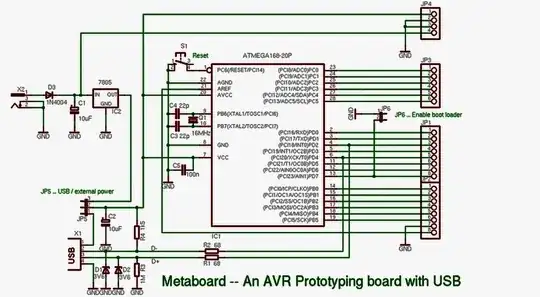

A (very) simple "more or less Arduino compatible" development board which can use this system is Metaboard. It's circuit diagram is shown below. As can be seen - it uses an ATMega168 and the USB connection is made to two standard digital I/O pins.
"Metaboard" using ATMega168
  • note USB connection to pins PD2 & PD4 - NOT via RXD on PD0 and TXD on PD1 via a serial to USB converter, as is more usual.

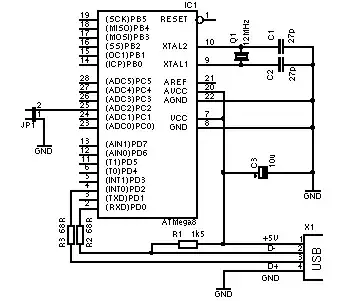

AND another version: AVRUSBBOOT
And again
BootloadHID They say -
  • BootloadHID is a USB boot loader for AVR microcontrollers. The uploader tool requires no kernel level driver on Windows and can therefore be run without installing any DLLs.
    BootloadHID is a USB boot loader for AVR microcontrollers. It can be used on all AVRs with at least 2 kB of boot loader section, e.g. the popular ATMega8. The firmware is flashed into the upper 2 kB of the flash memory and takes control immediately after reset. If a certain hardware condition is met (this condition can be configured, e.g. a jumper), the boot loader waits for data on the USB interface and loads it into the remaining part of the flash memory. If the condition is not met, control is passed to the loaded firmware.
    This boot loader is similar to Thomas Fischl’s avrusbboot, except that it is built on top of the HID device class. This implementation is more user friendly on Windows, since no kernel level drivers need to be installed.
