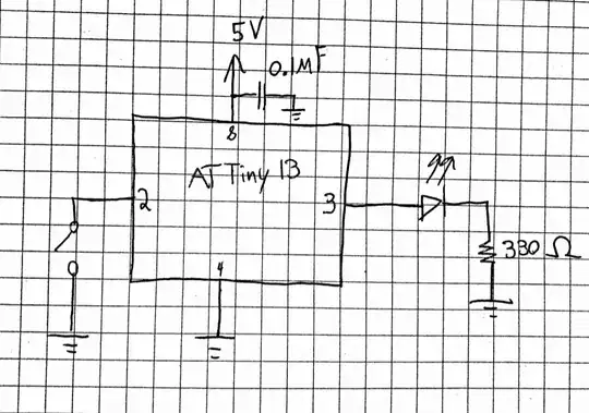

I have recently been working on a project that I had initially been designing with an Arduino Nano, and I was able to create functioning code for my application, but for cost / space reduction I decided to port the application to an ATTiny13 (because I had a few on hand). The problem is that for some reason, I cannot get the interrupt on the device to behave properly, and I was wondering if anybody could possibly give me a hand. I already performed a few experiments to narrow the problem down, and I think I understand the nature of the problem, but I have no idea on how to mitigate it.
Here is a rough schematic of my setup:
And here is the code I started with:

In theory, this should setup the pin that the button is on to have a pull-up resistor internally, and when the button is pressed, it should trigger a falling-edge interrupt which would thus set "LED_STATE" equal to 1. When the code returns to the main loop, it should see the flag and blink the LED before clearing the flag.
Now before I go any further, here is what I validated up to this point:
1.) The LED circuit is definitely wired up properly because I can manually set the "LED_STATE" flag to true in the main loop, and it will constantly blink at a rate of about once a second (given the clock frequency of 600kHz)
2.) The pull-up is definitely being configured properly, as I can see the voltage sitting at 5V until I press the button at which point the voltage falls to 0V.
So I decided to experiment a bit, and I set the LED high inside the interrupt, and removed that line from the main loop to see if the interrupt was even working, and to my surprise the LED was actually turning on, but it was not turning off:

You would want your bool LED_STATE = false; to be volatile qualified like volatile bool LED_STATE = false; otherwise the compiler's optimizer may assume that the value cannot be changing between loads and this can cause bugs in the generated code. This sounds like the principal problem you're having.
The ISC01 and ISC00 in MCUCR are for controlling edges detected on the "external interrupt" INT0 pin, which is PB1, package pin 6. This is essentially what attachInterrupt() does, which should be available to you in your board support package. If you can, it's probably best to just use that. In the case of using attachInterrupt() the use of volatile would still apply.
The other pins, like the one you've chosen, only only do Pin Change interrupts, hence PCINTn rather than INTn. Pin change interrupts only fire to tell that a pin changed, but not which pin (out of the group) or in what direction it changed. That is, it's ignoring what you've set in MCUCR.
If you want an external interrupt's ability to detect falling or rising edges using PCINTn interrupts, you must effectively synthesize this in software by tracking the old and new states of the pins, XORing them to determine what changed, and then either looking at the old or new state to determine what direction. NicoHood's PinChangeInterrupt library does this for you, and appears to support the ATTiny13. Likewise, volatile usage applies here as well.
