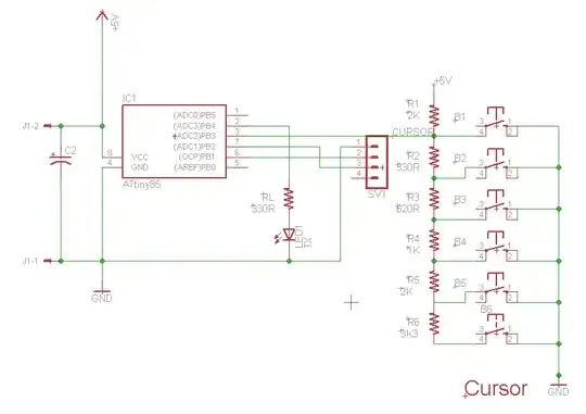

Here are the schematics and the board design for the remote controller:
RC schematic
The board is currently powered by 2 AA NiMH batteries that are currently at 2.6V. I can make the ATtiny85 blink with that voltage. I plan to power the RC with a 3.6V CR2 lithum battery.

I spent some time getting VirtualWire to work on attiny84. I see two issues with your code:
  1. Since the tiny85 only has one timer, that one is being used by both VirtualWire and millis/micros. So your delays won't work as expected.
  2. VirtualWire uses default values for vw_ptt_pin (10) and vw_rx_pin (11). Those pins don't exist on the attiny85. When vwsetup calls pinMode with these values, it causes writes to arbitrary memory addresses. This is likely to make your sketch behave unpredictably. To fix set vw_set_ptt_pin() and vw_set_rx_pin() to pins that exist on the tiny85 or modify the VirtualWire source.
