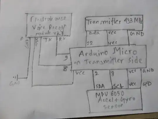

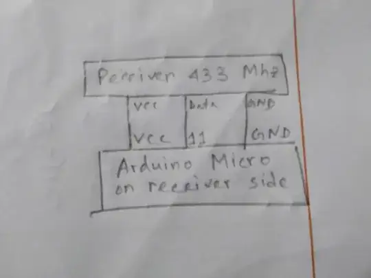

For my head mouse project which is based on the voice recognition module V3.1 for left click, double click, right-click operations, I am facing a problem. I am using 433Mhz Radio Frequency one-way Transceiver for sending data. When I use the MPU 6050 accelerometer and gyroscope for mouse cursor movement and the voice recognition module together on only one Arduino board, the mouse cursor moves smoothly and the voice commands work smoothly. But when I use the 433Mhz RF one-way transmitter for one Arduino board to calculate the mouse movement and figure out the voice command to send it in a wireless manner and receive the values and voice commands using the receiver module of the rf433 Mhz, the mouse cursor starts to lag. It doesn't move smoothly. Please help me solve the problem. The code and circuit diagram are given below:
RF 433 Mhz Transmitter Circuit of Arduino Micro with Elechouse Voice Recog Module V3.1 and MPU6050 motion gyro-accel IMU with
RF 433Mhz receiver circuit using Arduino micro

In general, you want to stream some data. and the mouse lag is one of the main obstacles in data streams; lag. so many classic causes such as buffer over-runs and timing problems come to mind.
The cheap 433MHz modules are not a good choice in case of streams. they lack any robust protocol, ACKing and security.
I would do this things to make it better:
  • use a better transmitter. maybe the cheap nRF24L01 ones.
  • use a bigger buffer
  • use two threads on the transmitter side. (e.g. use something like this, but two threads). one thread to collect data and writing it to a buffer, the next one to send data using nrf. furtunately, the nRF24 can send up to 32Bytes in one buffer transmission and the SPI interface is fast enough to fill it's buffer as quick as possible.
  • if you have to, use another thread to calculate movements from MPU6050. so you don't have to read it continuouesly and send all that raw data to reciever. you may use some interpolation on the receiver side though.
