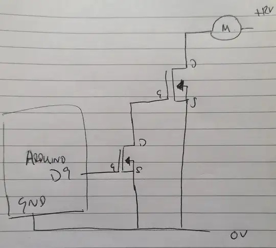

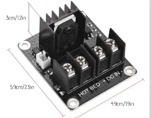

I've got 4x 12V 6a peltiers and some 3d printer mosfet controllers to drive them using PWM with my arduino. But I've found the mosfets need ~7V to switch on, so I'm now wanting to control them with some logic level ones I had around. I could just use the logic ones directly to the peltiers, but am finding it difficult to make my stripboard capable of handling 24A (this page seems to say I need tracks/wire of 2.3+mm diameter which I don't have). Hence I'm trying to make a circuit for the arduino to use the logic mosfets to control the 3d printer mosfets but can't quite get my head around how to do it. I think I'm missing a power source for the first mosfet - do I need to have a whole separate DC power supply for this to the peltiers? Very grateful for a bit of help please!
mosfet 3d printer controllers Proposed circuit - sorry the M represents my peltier!

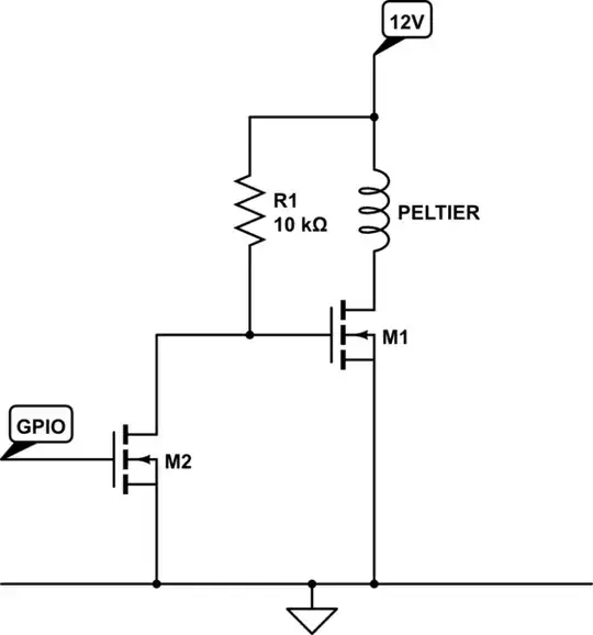

There's one thing you missed with your arrangement, and that is getting the 12V to turn the MOSFET on. In your current arrangement it's possible to turn it off, but never on. Adding a pullup resistor can help:
schematic
R1 pulls the gate of M1 up above the switching threshold to turn it on. M2, when on, pulls the gate down below the switching threshold, turning it off.
However: you may have noticed that the switching is now backwards: send a HIGH from the Arduino to turn it off. Which of course has the effect that the output is normally on and you have to actively turn it off.
Again a pullup resistor can help:
schematic
simulate this circuit
Now R2 keeps the gate of M2 pulled up (switched on) which keeps M1 turned of. That is, until you actively pull the gate down to ground by sending a LOW from the Arduino.
To ensure that the peltier never turns on when you don't want it to you should also take steps to ensure that the 12V power is never provided without the 5V also being provided - so you could maybe power the Arduino through the barrel jack from the 12V supply. It doesn't matter if the 5V is provided but not the 12V, but the other way around could mean the peltier comes on with no active control over it.
