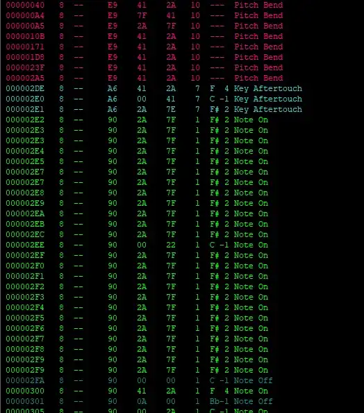

My next thing to do was sending 5 pin MIDI to rtpMIDI, and vice versa, using ESP8266, but so far I can't even send MIDI correctly. So far, I used this library, and it send midi without issues with Arduino Mega. But using Wemos D1, strange thing happens.
enter image description here this is output of MIDI OX. Pretty sure I wasn't sending MIDI CC.

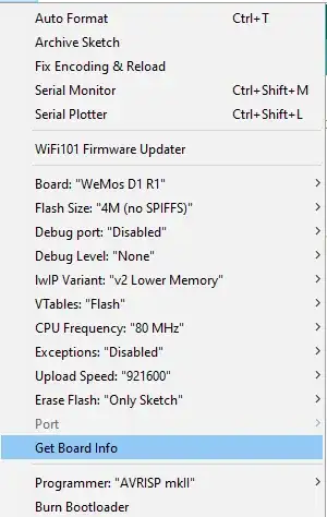

UPDATE : Here goes the settings.

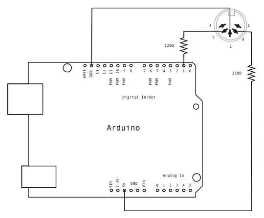

Schematics :
Basically I just change the Arduino to Wemos D1 Uno. enter image description here
