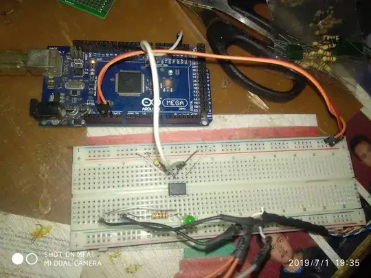

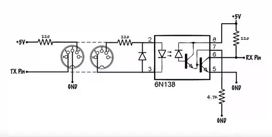

Here goes so far : I'm trying to follow this schematics from instructables, using 6N138. To make it easier, I'm going to copy his schematics. enter image description here
I'm using Arduino Mega. I tried to find specific topic about this and can't find any.
The target is actually send and receive MIDI, then replace the whole Arduino Mega to ESP8266 (probably the ESP-01, or Wemos D1), but I'm afraid it is too specific.
Here's the code so far on PasteBin

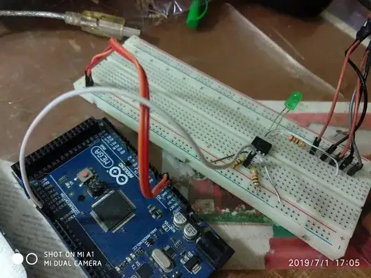

Here's my work so far. enter image description here 6N138
The diodes were replaced with LED, because I don't have one Original guide here. But that schematics on that thread also didn't work for some reason.

How to connect 6N138 to Arduino :
enter image description here Schematics : enter image description here
Basically the above schematics and installation is already okay, but instead of 1k, I used 10k on 6N138 PIN 7 to GND. VCC to 470 ohm is on PIN 6, also RX out, connected in series.

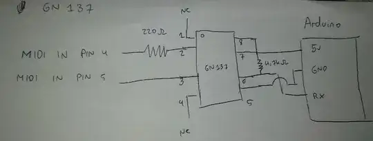

Just in case you want to use 6N137 :
  • Pin 5 of the MIDI DIN connector goes to pin 2 of the 6N137
  • Pin 4 of the MIDI DIN connector goes via 330 ohm resistor to pin 3 of the 6N137 (so the 6N137 pins and the resistor are connected in series)
  • You should also have a reverse connection protection diode between pins 2 and 3 of the 6N137 but I like living dangerously and rely on the diode inside the 6N137
  • Pin 8 and 7 are connected to VCC
  • Pin 6 is connected to RX
  • Pin 5 is connected to GND
  • 4.7 kohm pullup resistor between pin 8 and 6 (VCC and signal out)
Adapted from this blog post.
