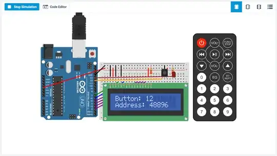

Example
This is an example circuit that has with an IR Remote and an LCD Screen.

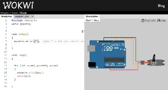

I am working with the new Wokwi Arduino Simulator. Wokwi Arduino simulator is based on AVR8js engine which is made open-source. You can find the link here
Following are the main features of the simulator
• Supports multiple file projects
• Supports the Arduino libraries
• Whatever compiles on the Arduino IDE will compile on the simulator
• Supported by all browsers
• Compiles with latest Arduino IDE
• Supports FastLED and many other peripherals
No download or installation needed
Easy to share the code and project with just a single click
• Smart - Code Autocompletion, Code auto-formatting are supported
• Provides standard library demo examples
• Project can be compiled on RUN on Mobile browsers as well
• Tries to be closer to real circuits – Example – Button bounce like in real hardware
• Supports Arduino Mega, Arduino Nano, Arduino UNO, ATtiny85
• Supports assembly instruction execution

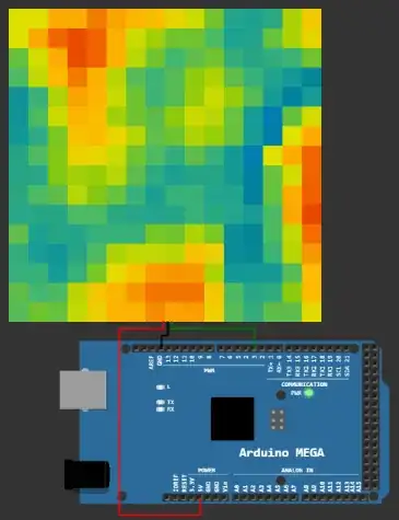

• Provides LED power and FPS features for FastLED projects
• Supports a plethora of Arduino peripherals for the project – Ultrasonic sensors, Slide switches, NeoPixel matrix, Potentiometer, Servo motors, SSD1306 OLED displays, temperature and humidity sensors, rotary dialer, membrane keypad and more
Serial monitor is supported as well

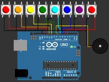

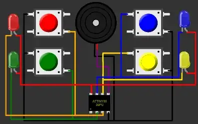

Simon game using ATTiny85, buttons, buzzer, and LEDs
Project link: https://wokwi.com/arduino/projects/285525640477671948
• Note the use of the same pins for both output and input • The code can be written for ATTiny85 the same way how it is written for Arduino

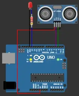

HC-SR04 Ultrasonic sensor Example
Project link: https://wokwi.com/arduino/projects/290056311044833800
A very useful project to build several interesting projects (RADAR 3D mapping and more )

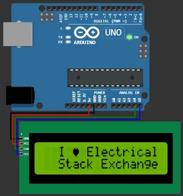

LCD1602 display example in Wokwi Arduino Simulator
Project link: https://wokwi.com/arduino/projects/287736345015616008
LCD1602 is one of the best HMI and has been here for a long time. It helps in debugging projects during run time, we can also use it along with a keypad to make a completely practical HMI (human-machine interface). Very easy to use, and easy to learn about programming.

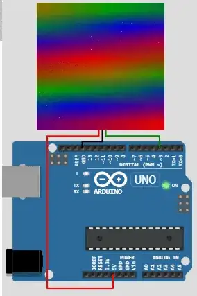

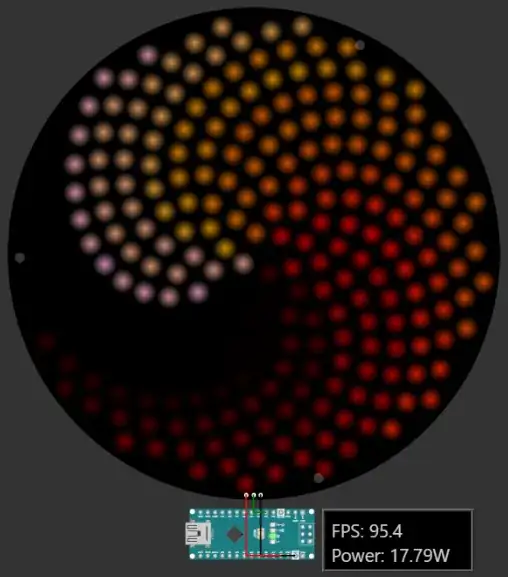

FastLED example with FPS and LED power
Second link: https://wokwi.com/arduino/projects/281176629596652040
FastLED is a second revolution in the history of LEDs. It was never easier than now to program multiple LEDs with just one Arduino Pin. With the growing FastLED community (reddit, wokwi-Discord, and others) and FastLED examples and libraries, This is one of the most important elements in the wokwi Simulator.

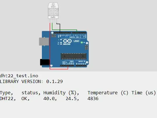

Temperature and humidity sensor, Real time clock module example

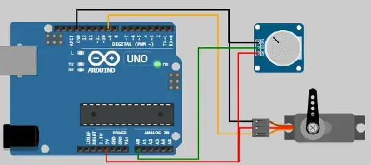

Yes, you can, try using Proteus ISIS for simulating your code...
For full emulation of Arduino, there is a shareware program called VBB (Virtual BreadBoard), I tried it too and it was nice.
Edit: You can check my detailed tutorial here on how to simulate on Proteus ISIS
