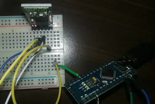

I am using an Arduino Mega 2560 clone by Elegoo to program this Bluetooth module. Currently I have it wired up using this diagram
Currently I have it modified slightly to use a voltage divider between the Arduino's Tx and the HC-05 Rx, as the HC-05 works on 3.3v logic. The one possibility I think could be causing this problem is that the Arduino Mega is just interpreting all Tx incorrectly as I measured that it sounds ardoun 3.2 volts for a high voltage. According to multiple websites the HC-05 is in AT command mode when the LED flashes slowly, about once every 2 seconds, which is happening. I put it in command mode by holding down the button above the EN pin while providing power to the HC-05.
I have been using pin 14 and 15, which are Hardware Serial3 on the Arduino Mega. Here is the code I have written:

EDIT: I have now received some unrecognizable responses from the controller after sending AT multiple times, here is the screenshot, included is a video of my circuit, which shows how the LED is flashing:
https://drive.google.com/open?id=1mc8PEEnhiKpPzzy5kL9QxTvoQA3NAH6b
The only modification to the code is adding a Serial.println("TESTING"); in the while loop that reads Serial3. I have tried using other Hardware serial ports as well, all with the same result as the above screenshot.
