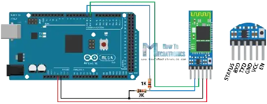

I'm not able to give AT-Commands, and as a result the device is not able to pair with my phone. My setup looks something like this:
With minor differences being that I'm using an Uno board instead of a Mega, the RX and TX pins are connected to...well, I tried a lot of different pins, from the default RX/TX pins to specifying other pins like the ones in the code, as well as reversing the connections (RX to TX, TX to RX), also this schematic neglected to mention the 'ENABLE' pin, which I connected to my Arduino's 3,3V pin.

There are basically 2 ways to communicate between the Serial Monitor and the HC-05:
  • You can connect the HC-05 directly to the USB Serial chip on the Arduino board, thus you would communicate directly with the HC-05. In that case the TX and RX pins are used, since they are connected to the USB Serial chip. But the labels TX and RX are referring to the Arduinos chip (Atmega328p at the Arduino Uno). Since serial connections need to be connected alternating (RX to TX and TX to RX), the pin labeled TX leads to the RX pin of the USB Serial chip and vice versa.
    Thus you would connect TX of HC-05 to the TX pin on the Arduino and RX of HC-05 (through the voltage divider) to the RX pin on the Arduino. Also you should program the Arduino with an empty sketch before doing that, so that the Arduino does not interfere in the Serial communication with its own Serial usage.
  • Or you can use a SoftwareSerial interface and let the Arduino code translate between the devices. The Arduino received from the PC and sends the data to the HC-05. Also it receives from the HC-05 and sends that data to the PC. This is what you were trying. But you absolutely need to specify a different set of pins for the SoftwareSerial interface, than 0 and 1. These pins are doing the hardware Serial interface, which is connected to the PC. So change these pin numbers (for example to 2 and 3).
    In fact: Whenever you see a code for Uno, Nano or Mega using SoftwareSerial on pins 0 and 1, you can be sure, that it is garbage.

some don't use a voltage divider
The chip on the HC-05 board is a 3.3V device. The actual breakout boards, that can be bought everywhere, mostly only add a voltage regulator from 5V to 3.3V, an LED for status display and break out the necessary pins. The data pins are mostly directly connected to the chip. There are many resources, that claim the HC-05 to be 5V tolerant, but also many that antagonize that. To be sure not to destroy the HC-05, you should also use a voltage divider.
