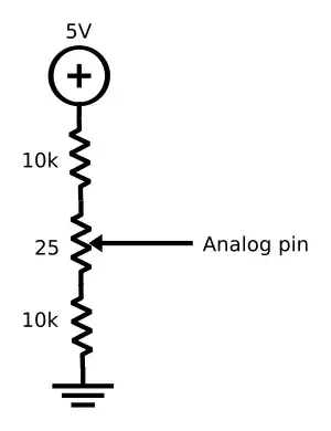

So, if I included a 10k resistor on either side of the pot that should address the current issue but it leaves the question of whether the remaining 25-ohm range is too small for the ADC to register distinct values, ...
The 10k resistor will stop the current problem, but now the range in the voltage divider will be ridiculously small. The setup will now look like this:
Pot with resistors
Unfortunately the range you are going to read with the analog input is going to be (voltage divider formula):
Vout = Vin * (R2 / (R1 + R2))
With the wiper at one end R1 will be 10000 and R2 will be 10025 and with the wiper at the other end it will be vice-versa. So the voltage you get will be:
Vout = 5 * (10000 / (10025 + 10000))
Vout = 5 * 0.499
Vout = 2.497
Or:
Vout = 5 * (10025 / (10025 + 10000))
Vout = 5 * 0.501
Vout = 2.503
In other words you will always be reading about 2.5V and therefore your analog read will always return around 512, which won't be much use to you.

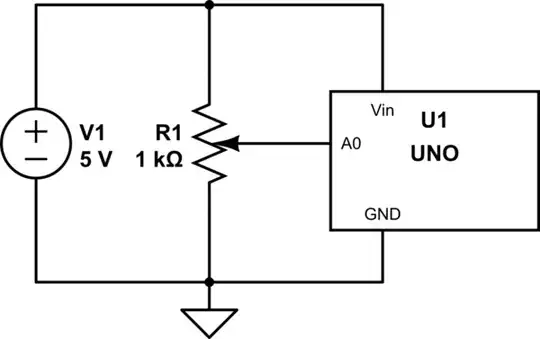

Most potentiometers take the form of a 3-terminal device, where the two outside terminals are a fixed resistor and the middle terminal adjusts the tap from one extreme to the other.
schematic
In this configuration, you end up creating a simple voltage divider. You should pick the potentiometer's voltage such that the fixed portion does not draw more current than necessary, regardless of the tap position. (The arduino's analog input itself does not draw any significant current really.)
If you use a 1k pot, then the current always flowing from 5V to ground is 5mA, which should not tax the Arduino's voltage regulator too much. If you used a 100 ohm pot, then the current would be 50mA -- not likely to damage things, but certainly more than is necessary just to operate a voltage divider.
If you use a 1M-ohm pot, then you are working with 5 micro-Amps, and at that low current, noise from the power supply starts to interfere with your analog readings.

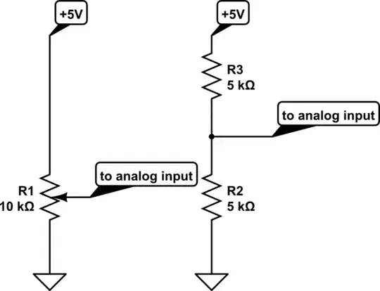

The point in using a potentiometer for providing analog input is, that the total resitance is always the same, regardless of the position. See this schematic:
schematic
Both voltage dividers have the same total resistance (10kOhm). If you set the position of the potentiometer to the middle, they have exactly the same output: 2.5V. Moving the slider of the potentiometer is the same as taking some of the resistance from one of the resistors on the right and adding it to the other. So a potentiometer is a variable voltage divider. Normally you want the current, that flows through this voltage divider to be small, because it would be only wasted to heat the resistor strip. If you are using a potentiometer with 25 Ohm total resistance while having a 5V power supply, the current trough it would be 200mA, which is pretty much. And if your power supply cannot give you that much, your application will get really instable.
