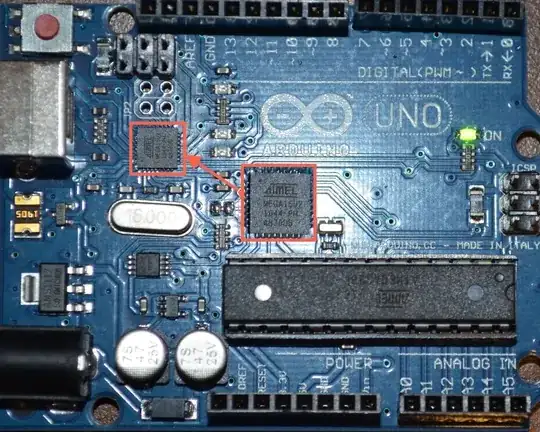

You can identify these boards by the chip that is nearest the USB connector.
That small black chip with the Atmel logo on it is the USB interface chip.
Boards of this style have the USB drivers included in the Arduino IDE. If you have installed the IDE properly the drivers should have been installed for you automatically. Also Windows 10 (finally) contains "class compliant" drivers for CDC/ACM, so no drivers actually need to be installed for these boards anyway (installing the Arduino ones doesn't hurt, though, and helps it to show the right board name in the device manager).

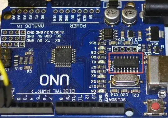

The other category of board, "Custom USB Profile", use different chips. And there's lots of different chips it can be using.
Early Arduinos and some other makes of board (such as chipKIT boards from Digilent) use the Future Technologies RT232R chip. This sometimes looks at first glance like the Atmel chip above, but is very very different. You have to check the number on it to be sure. Other times a different package is used and it's obvious it's different.
Then there are the cheap clone boards you get on eBay and Amazon. These, more often than not, use yet another chip - the CH340G. This is a fraction of the cost than the FT232R or ATMega16U2 chips, which is why cheap boards tend to use them. They're also less reliable and harder to get working in some operating systems (most notably OS X).
For these kind of chips you need to install the right driver for the specific chip you have. For the FT232R chips that's not too hard - Future Tech have the drivers on their website.
The CH340G driver is harder to find from a reliable source.(someone with more knowledge please fill this in)

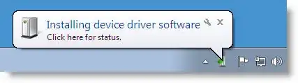

When you plug it in for the first time it should pop up a bubble saying it found new hardware:
Or something similar to that. It should also make a noise.

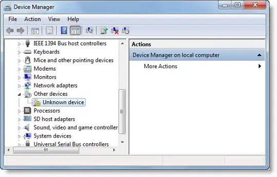

Right - the other direction to go in is if it does identify that you plugged a board in, but can't install the drivers. Maybe it's saying the device failed, or it can't find the drivers.

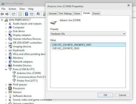

Step one is to go into the device manager and look for an "Unknown Device":
That is most likely the Arduino. You should be able to inspect all the data for it to find the USB Vendor ID (VID) and Product ID (PID). If those are showing up as corrupted, not available, or FFFF, then your Arduino has a serious problem and Windows cannot work out what it is. In this case it may be that the USB interface chip has failed (there have been unsubstantiated rumours that shorting 5V to GND on an Uno R3 can kill the ATMega16U2 chip). There's not much you can do when that has happened.
If you can find reasonable data in the device manager, as in the image below, then it's going to be a case of trying to fix (or find the correct) driver, since you may not have the right one installed. Also note that some other board manufacturers use the same VID and PID as the Arduino and having their drivers installed could cause the Arduino to not function properly - you should uninstall their drivers first, or manually set the Arduino to use the proper Arduino driver.

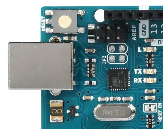

Here is a picture of a "counterfeit" Arduino UNO. It uses the ATMEL MEGA 16U2 chip as a USB interface which is "suppose to work" with OS X's existing drivers. If you have one of these and it's "not working", don't bother installing the FTDI drivers because that won't solve your problem.
Unfortunately, what works on one version of OS X doesn't always work on another version. Solutions are usually specific to OS X versions, but there are some common troubleshooting steps to follow once you know what Arduino USB Interface you have and you've installed the correct driver (if required).

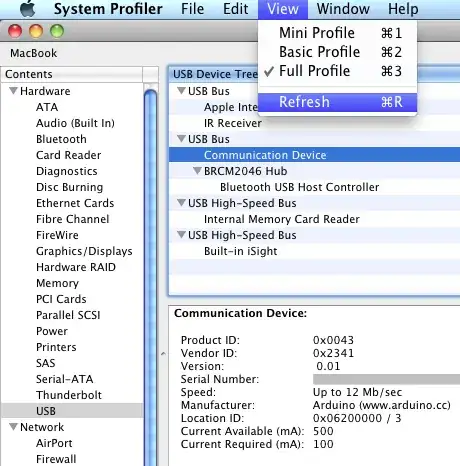

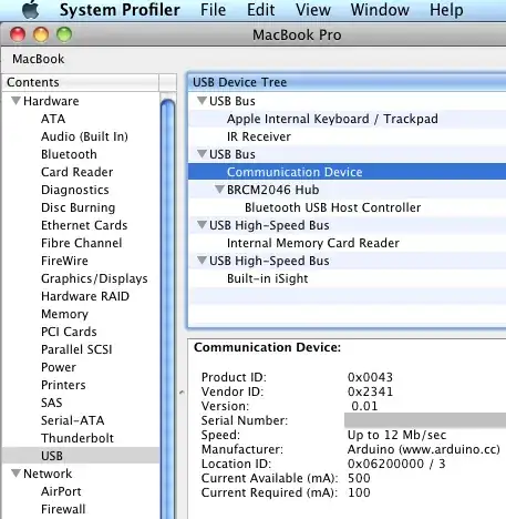

Verify that OS X is recognizing your device.
  1. Click on the Apple icon in the top left corner of the menu bar.
  2. Click on "About This Mac".
  3. Click on the "More Info…" button (OS X 10.6) or "System Report…" button under the "Overview" section (OS X 10.7 and higher).
  4. Expand the "Hardware" menu item and click on USB.
You should see something like this:
If you plugged in your Arduino and is not listed somewhere on the USB Device Tree, I can guarantee it will not show up in the Arduino IDE Serial Port Menu. It won't show up in the /dev list using terminal either. Please keep in mind that System Profiler does not refresh automatically. If you un-plug your Arduino and plug it back in again, you have to MANUALLY re-fresh System Profiler to see the current data
